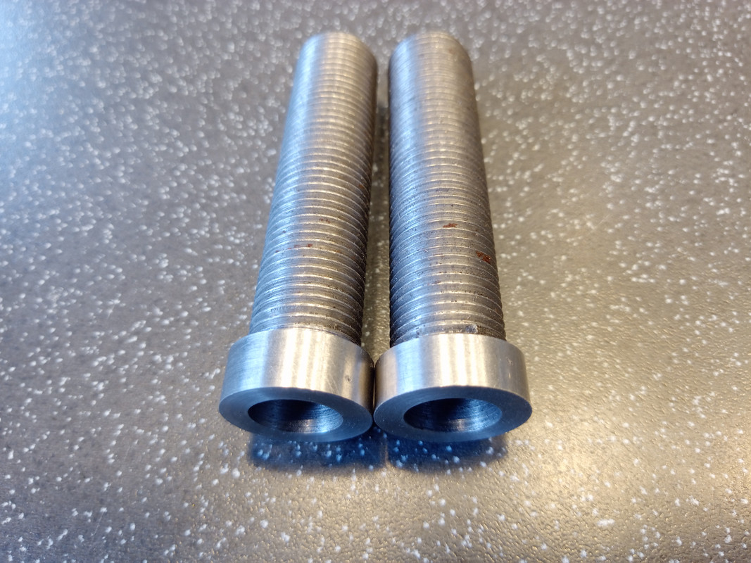

Here are some before & after pictures.
Before:

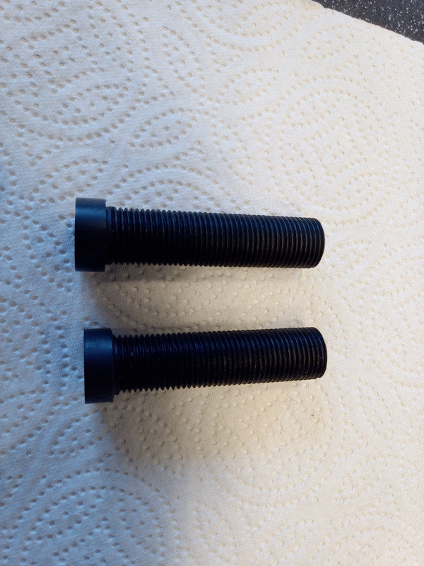

After:
They don't look too bad at all - At least as not so spotty-looking as some I've seen, and reasonably dark.
Don't bet the farm on rust resistance, though - I think it will help a little, but it ain't hot dip galvanizing .....
