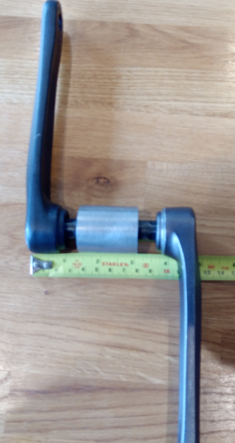

Sorry I am a little confused, was that for a unicycle ?I once had to make a custom square BB axle.
Wasn't sure the hardened steel would take well to welding, so I did it the hard way.
Used a hand file and hand tap.
do you mean the hardened steel would have lost temper after welding, but you didn't lose yours filing for ... hats off
Why wouldn't a higher carbon steel weld together?Yes, it was for a unicycle.
I made the axle from a chuck of steel rod. I hand filed it square, then drilled and tapped the bold holes at the ends.
I had tried welding a square bike axle together once, but it failed due to being higher carbon steel.
Brad
The heat effected zone will become brittle unless allowed to cool extremely slowly. Even then... kinda iffy.Why wouldn't a higher carbon steel weld together?
I hope that my melting the base stuff of both halves and stirring them with the tig-torch flame is enough to re-introduce the 2 halves.
It is only after that was happening that I added filler material.
Well you have me worried now.The heat effected zone will become brittle unless allowed to cool extremely slowly. Even then... kinda iffy.
I tried a pre and post heat on steel like this with some success, but decided it just wasn't worth the risk.
Here is what I did (ultra high tech) to test the bb axles I tried welding after they cooled...
Put them firmly in a large vice with boards between to protect the races, then hit the extended end as hard as I could with a 4 3 foot long bit of 4x4 lumber.
Of 4 of them which I pre and post cooled as well as chanfered for proper 100% weld, all but one shatered at the weld.
I figured I may be subject to a leg injury if I was really pushing hard on the cranks and one sis that, so I chickened out and started using the lower carbon "drill rod" to make my own. Did a narrow one like yours and two mega wides for choppers, all good.
Maybe my basic buzz bix was just too crude for such technical welding!
Brad
Yup, I get that completely. I have destruction tested it and it failed far more easily than I had anticipated. But I was whaling on it with my 200# on a 2 & 1/2 foot extension tube.Cracks propagate. They creep over time. So your testing should have push and pull cycles of around 80 cadence frequency for several hours and then repeated for? I don't know. So this becomes a destructive test.
Safety factors could be as high as x5. I think my firm used about x3 at the low end. So we'd test lifting capacities, for example, with 3x to 5x times the weight of the lift requirement.
Did you read the welding link that I put up?
All in all, an engineering firm would not make the short BB the way you have. It would be machined as one piece without any welds.
But they are up against possible corporate convictions if things go pants.
Just saying.
The TIG welder giveth, and the cheater bar taketh away .......But I was whaling on it with my 200# on a 2 & 1/2 foot extension tube.![]()
Hmm - Next weakest link theoryput a keyway in
Yes, I think they are hot forged and "stamped" out as blanks and then have the bearing mounts machined and the ends drilled and tapped.Hmm - Next weakest link theory
Maybe, if you used a high strength key, and machine to a close tolerance fit.
What about re-visiting the weld idea, only instead of a butt joint, mill a half-lap joint, and weld around the entire seam.
But you need a mill, either for a keyway, or my half lapped idea - Maybe time to tool up
Those BB axles have the look of being forged, to my eye, rather than just machined - Probably what makes them strong.
The hole was 8mm and I did have the inner/bottom surface glowing bright orange and I thought I had "stirred it around" with the tig flame before introducing any filler. Oh well, I shall go another route.Plug welding is notoriously hard to perfect. Lots of competent welders have had failed plugs on joining bits of car together. It's much easier to weld the edges of the tube and should create a much bigger welded area too. The tube may need to be shorter to keep weld off the bearing seat.
If using a mig and plugging you absolutely have to strike the arc on the inner or bottom steel. If you light it up on the edge of the plug hole the puddle gets minimal penetration to the bottom bit. I guess tig has a similar need to attach to the lower bit first. The smaller the hole diameter the harder it is.
Crikey I go away for 2 days racing and this think all falls apartYup, I get that completely. I have destruction tested it and it failed far more easily than I had anticipated. But I was whaling on it with my 200# on a 2 & 1/2 foot extension tube.![]()
We don't wash our dirty linen in public, only our successes.Crikey I go away for 2 days racing and this think all falls apart
So I can't see any description or pictures of how/where it failed ? so we are just guessing what any remedy/alternate build method maybe ?
