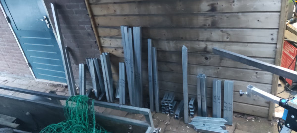

We finally started. We'll we started already with the wheels. They are finished now, but we started cutting the steel tubes.
It was a lot of work, but this is almost all the steel we needed.
Driday we start welding.
I think that it will take a few days, but I hope that next week, the base frames are welded.
Tubing is this time 2mm think, instead of 1,5 what i normally use. It was cheap and good quality and for some parts better. Also easier to weld.

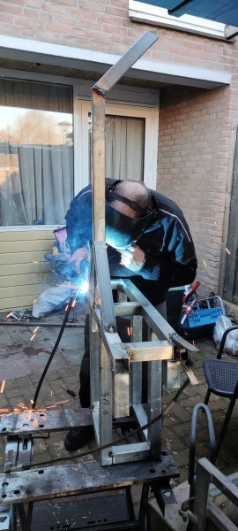

I will post some images as we welded friday.

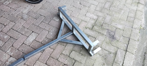

We started welding. This Monday we go further and hopefully we will finish the main frame of one of the 2 quads.
I will post more photos ss we welded Monday.

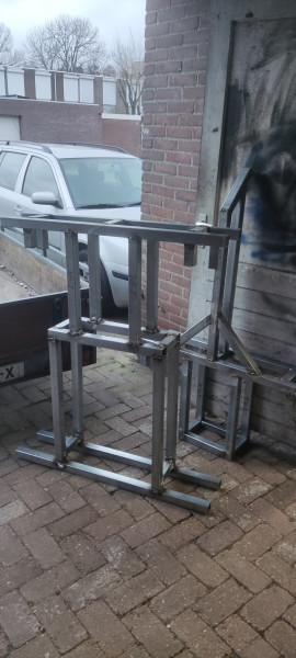

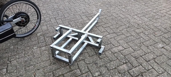

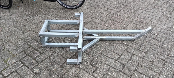

First base frame is welded. We aren't finished, but the base is ready and Wednesday we start with my frame.
Wheelbase is about the sand, only 26 inch all around.
Now it starts to look like something.

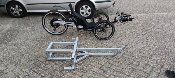

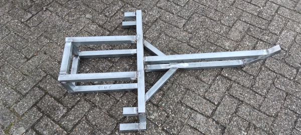

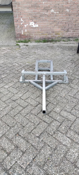

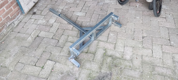

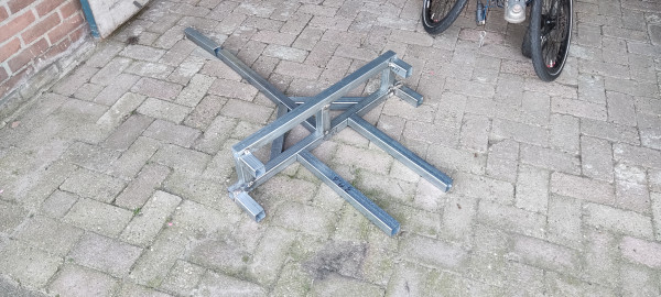

Front frame is mine and rear frame is from Baddas-cycles.
Mine has the rear part, but isn't that much longer. Front will be about 15 to 20cm longer. I must decide what I do, but probably I keep it as short as possible. Making the sides fold open, so it gets just over 2m wide. This makes that I can sleep in it, but still have a compact size quad.
Left some metal parts out, to safe some weight. It was also not needed. The big opening in the back, will probably hold my electronics, batteries and storage space.

We buyed 80kg steel for both quads. Those are 40mm x 40xmm and 2mm thicknes. The steel tubes have a zinc coating so before welding first clean up the tube with the flapdisc on the angle grinder.

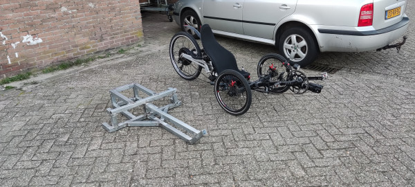

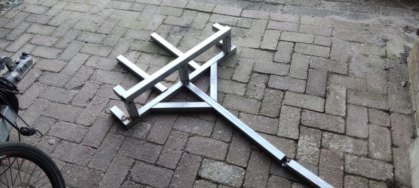

Mine will be different, because I will sit lower and the rear suspension will be different.
But the concept is about the same.
The rear has the option to Cary stuff, or just like this one, pull a trailer/caravan.
I also want to build a new caravan, but I start with the quad.
