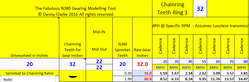

Unsure what you tables are showing ?
One has 4 rows 1.87 - 1.90 the other has 3 rows 1.88 to 1.90 ?
Can we assume you comfortable cadence is 60 rpm ? or is that really your max for a short while ?
Where does the motors maximum efficiency lie ?
So if :-
36T gives 10.8 mph @ 60 rpm
28T gives 15 mph @ 60 rpm [ assumption from figures given ]
20T gives 20 mph @ 60 rpm [ to fast to be of much use ? ]
I have no speedo [ a curse and a blessing ] I reckon my comfortable cruise speed to be about 10.5 to 11.5 mph just above your max available last week.
You are hampered further by a greater trike weight than mine so comparisons are NOT in your favour :(
3,900
In answer to your questions.....
No significance in this, I just carved up the N380's gearing ("X" * 0.5 to "X" * 1.9) into 0.1 steps when creating the spreadsheet. It is just a scrolling difference when looking at the big output table.
A 28T sprocket with a 53T chainring will give about 12.84MPH at 60 Cadence, 15MPH @ a cadence of 72.

3,900
I had a look at the tech specs for the BAFANG motors.
Both of mine are the BBS01 36v 350W so their "Under Load" RPM is a max of 75.
I have searched for info on where the "sweet-spot" is for the motor (RPM/Watts) but not found it yet.
Assuming 75 RPM is where they intend it to sit most happily I would see the following Speed(s) at varying cadences.
This would all be in the top-ring 53T, for towing a loaded trailer (camping) I would stay in the lower ring (32T)
Which would give the following Gear-Inches and Speeds. Note the max speed is still more than adequate for any inter-site travel. :)
