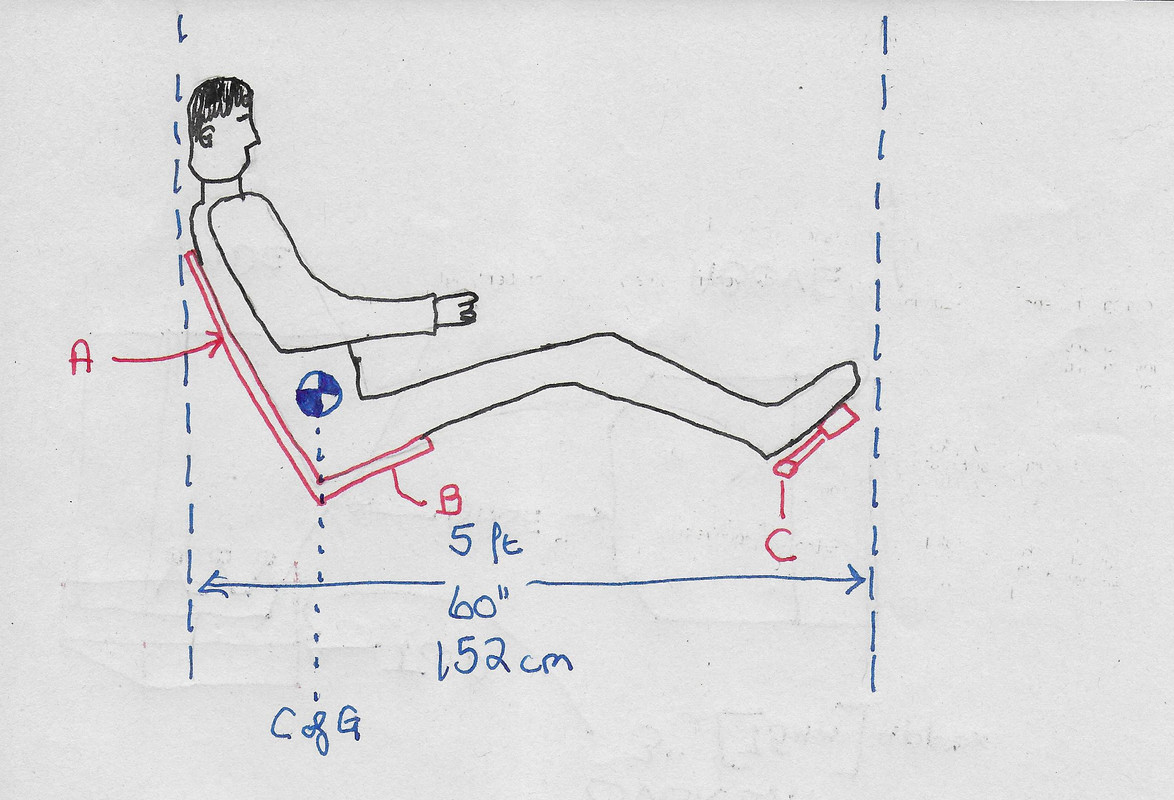

So first thing to do is look at the engine and it's mounting [ i.e seat ]
Now the 60" is not fixed and depends on several variables some change able and some constants ?
| Constants | Variables | |
| Leg length | Seat back angle | the more laid back the seat back the longer the engine becomes |
| foot length | Pedal crank length [ not really ] | short cranks just move BB forward , maybe useful ? |
| height difference between seat base & BB | Obviously if yours knees were bent 90' it would considerably | |
| shorten the trike at the expense of more height and less power |
From the example above it can be seen if the rear wheel axle was on the left hand dotted line that would add 1/2 a wheel diameter to the length 10" [ 25cm ] for a 20" [ 405 ] wheel
If a normal fork was mounted in front of pedals 2" [ 5cm ] for clearance and a 20" [ 50cm ] wheel adds another 22" [ 55cm ]
This gives a total length of 92" [ 232 cm ]
